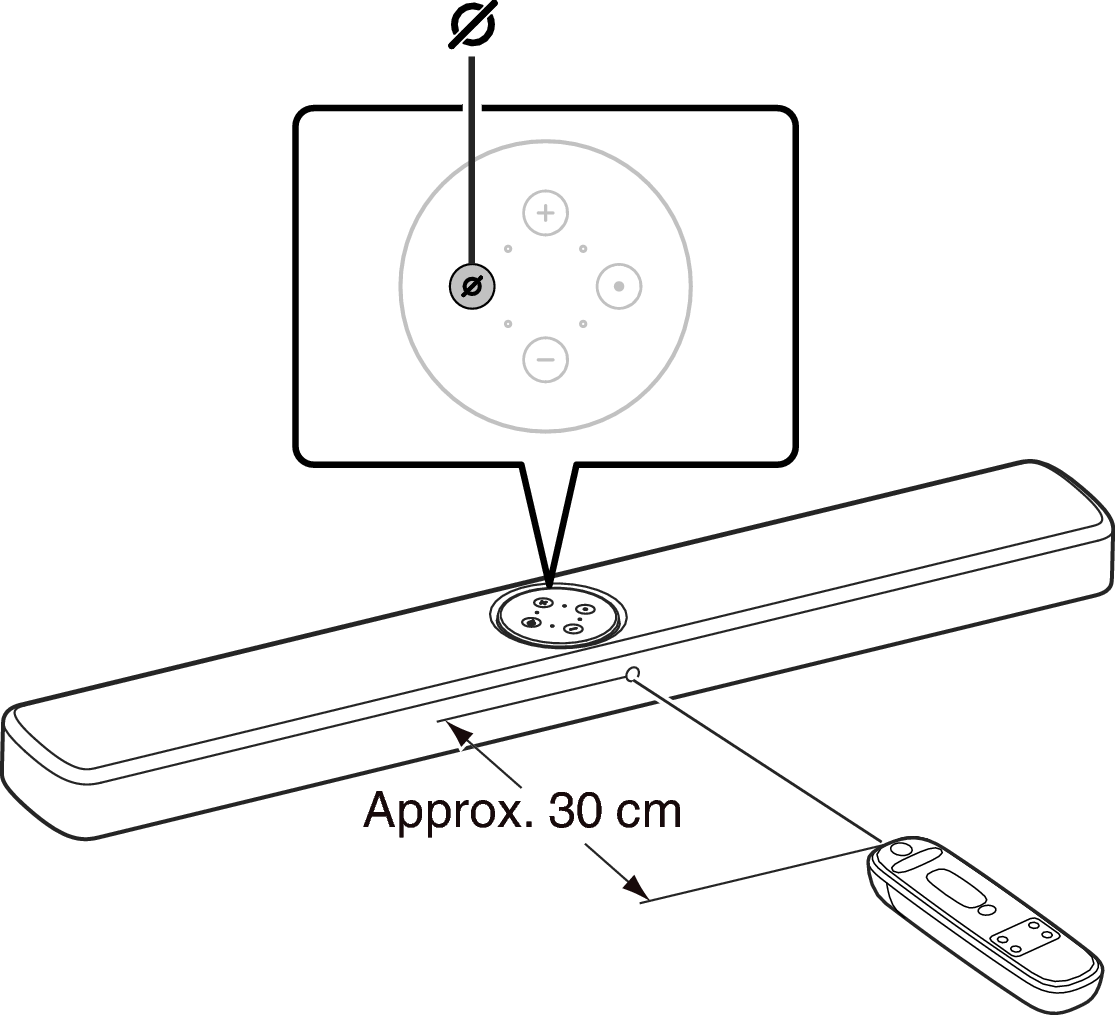

Using the remote control learning function
Press and hold the Icon_MicMute for 3 seconds or more until the voice guidance responds.
Point the remote control of this unit at the remote sensor of this unit and press the remote control button to be learned (e.g. VOL +) once.
The voice guidance responds.
Pict Learn POLK REACT
Point the remote control of the TV at the remote control sensor of this unit and press the remote control button to be learned (e.g. the button to increase the volume) 3 times.
If learning is successful, the status LED blinks in green once, and the voice guidance responds.
If learning is unsuccessful, the status LED blinks in red once. Repeat steps 2 and 3 if this happens.
When the status LEDs blink in white again, press the TV remote control button (e.g. the button to increase the volume) once more.
To learn a new function, repeat steps 2 and 3 with the next function.
Press and hold the main unit’s Icon_MicMute for 3 seconds.
The unit exits remote control learning mode.
Confirm that the operation (e.g. increasing the volume) can be performed on this unit with the TV remote control.
