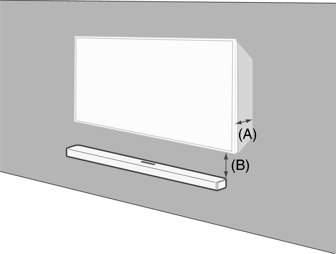

(A) Depth of the mounted TV
(B) Required space between the bottom of the TV and the top of the sound bar
Less than 64 mm
More than 50 mm
64 – 102 mm
More than 102 mm
More than 102 mm
More than 191 mm
When hanging the sound bar on a wall, use the included wall mount template.

Leave enough space between the TV and the sound bar so that the sound from the Atmos speakers on the top of the bar, which projects towards the ceiling, is not blocked by the TV. Refer to the table on the previous page for spacing recommendations. link

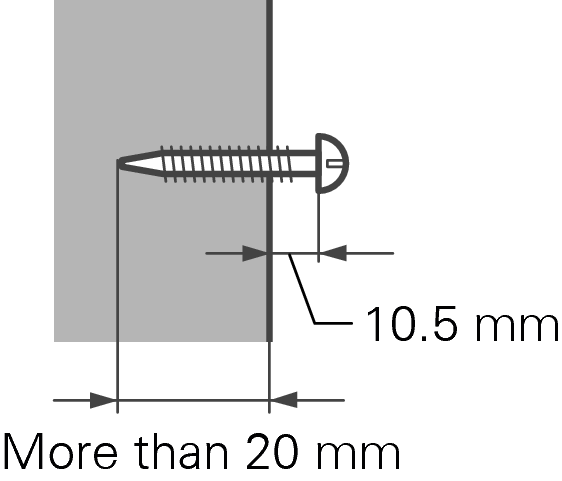

Screw in the wall mount screws by following the template.
Screw in one self-tapping screw (commercially available, 5 mm to 6 mm diameter) into a wall that has sufficient strength to support the weight of the sound bar, or into reinforcing material on the wall.
Screw in the wall
