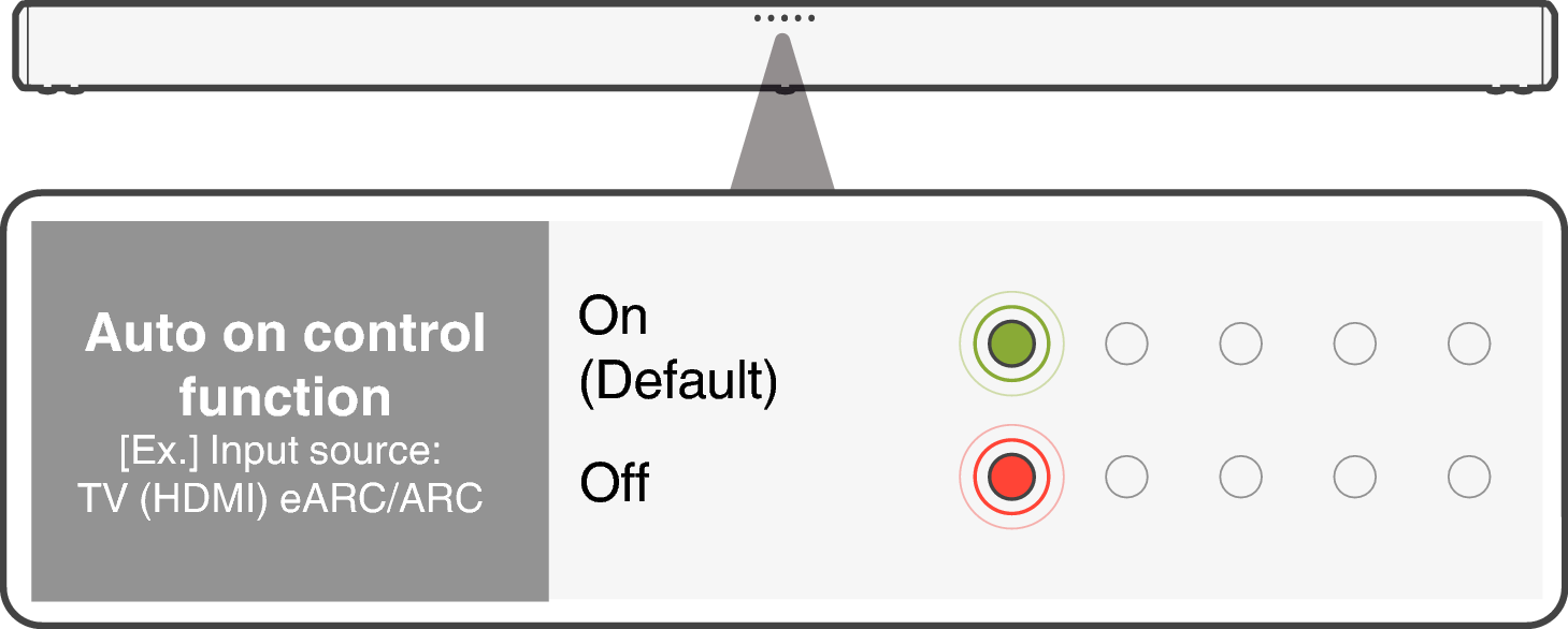

Automatically turning on the power according to the playback of the playback device (Auto on control function)
If you turn on the auto on control function and playback is started by the playback device while this unit is on standby, the power of this unit is automatically turned on and playback is started. In addition, if the power is on, the input source is automatically switched according to the playback of the playback device. The auto on control function can be set to on or off for each input source.
Input source |
Button |
TV (HDMI) eARC/ARC |
TV |
OPTICAL |
TV |
AUX |
AUX |
The status LEDs in the display of the current input source blink three times.
Even if the auto on control function is on for the optical input or AUX input, the input source will not switch automatically during HDMI (eARC/ARC) playback.
When this unit is in deep standby mode, the auto on control function of the optical and AUX inputs cannot turn on the unit. link
