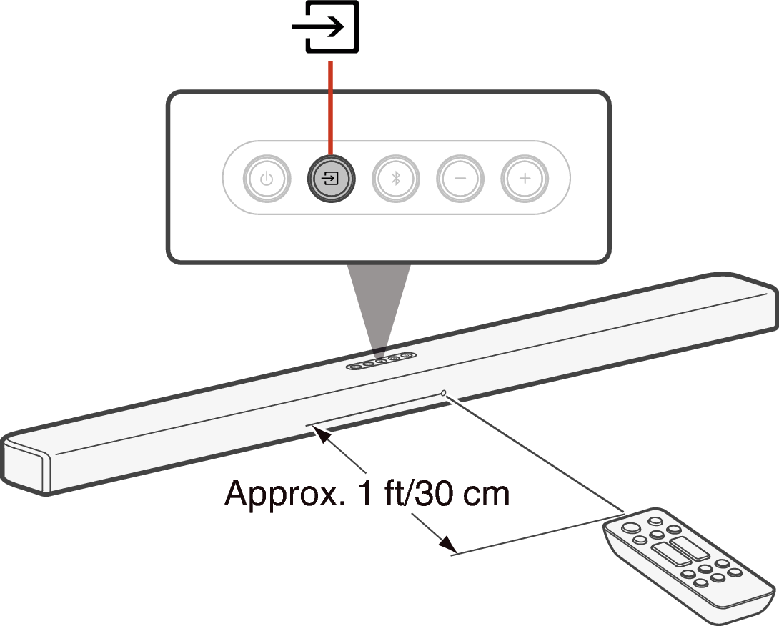

Using the remote control learning function
Press and hold the main unit’s Icon Source for 3 seconds or more.
Among the LEDs on the status display, one white LED light moves back and forth from left to right and indicates that the remote control learning mode has started.
Point the remote control of this unit at the remote sensor of this unit and press the remote control button to be learned (e.g. VOL +) once.
All status LEDs blink in white.
Pict Learn Signa S4 NA
Point the remote control of the TV at the remote control sensor of this unit and press the remote control button to be learned (e.g. the button to increase the volume) once.
If learning is successful, the rightmost status LED blinks in green three times.
If learning is unsuccessful, the rightmost status LED blinks in red three times. Repeat steps 2 and 3 if this happens.
When the status LEDs blink in white again, press the TV remote control button (e.g. the button to increase the volume) once more.
To learn a new function, repeat steps 2 and 3 with the next function.
The rightmost status LED blinks white three times and indicates that the remote control learning mode is completed.
The unit exits remote control learning mode.
Confirm that the operation (e.g. increasing the volume) can be performed on this unit with the TV remote control.
