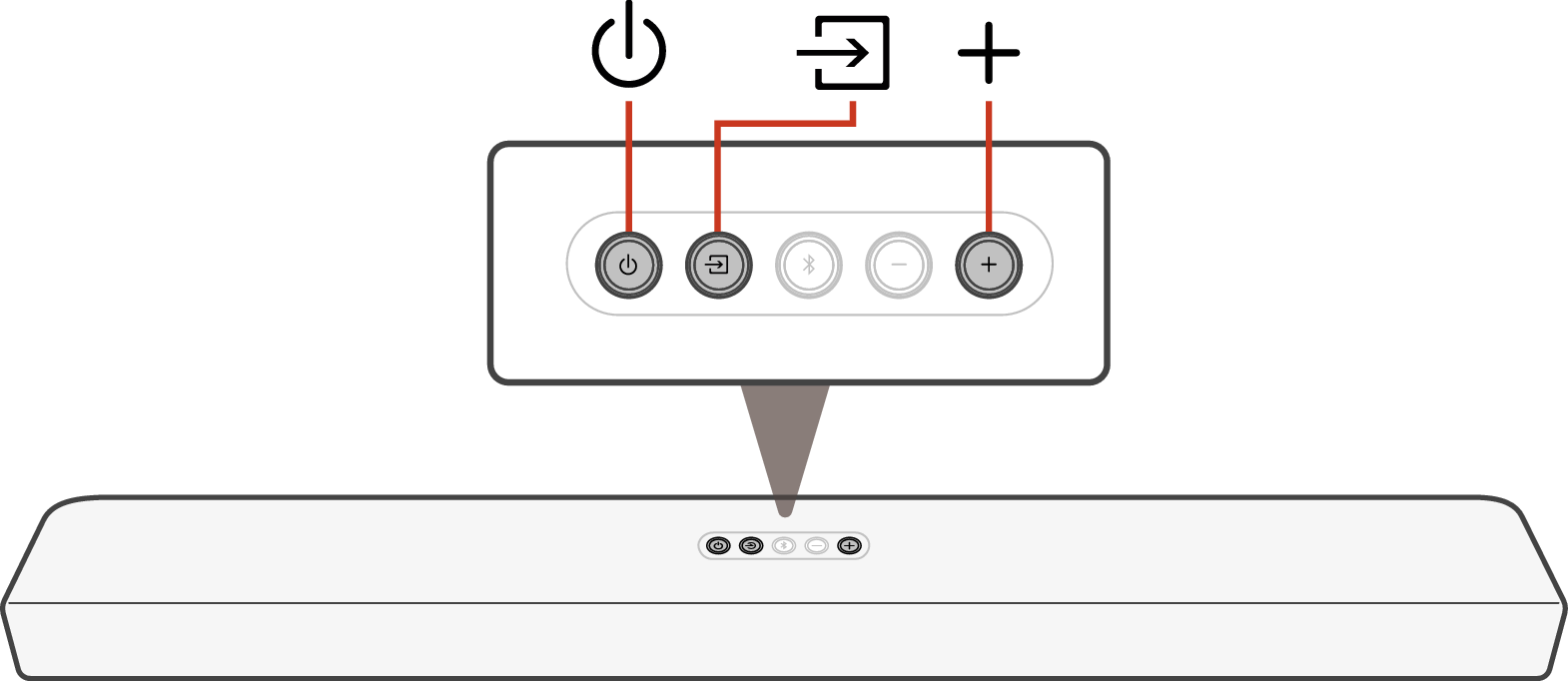

Ope Reset Signa S4
Press Icon Power to turn on power to the unit.
Press and hold the main unit's Icon Power , Icon Source and + at the same time for at least 5 seconds.
The status LED blinks in red three times.
Wait for around 10 seconds after the LED turns off and then press Icon Power .
All settings return to the factory settings after the sound bar is restarted.
