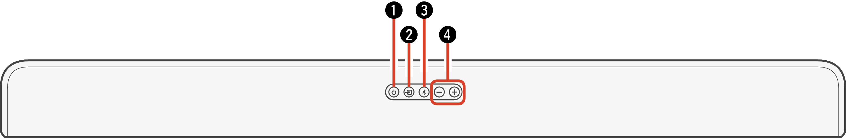

Top panel
Power operation button (
Turns the sound bar power on/off (standby). link
Links to sound bar power and turns the subwoofer power on/off (standby).
Input source button (
This selects the input source. link
Switches the input source each time the button is pressed.
Bluetooth button (
Switches the input source to “Bluetooth”. link
Used to pair with Bluetooth devices. link
Volume buttons (+, –)
These adjusts the volume level. link

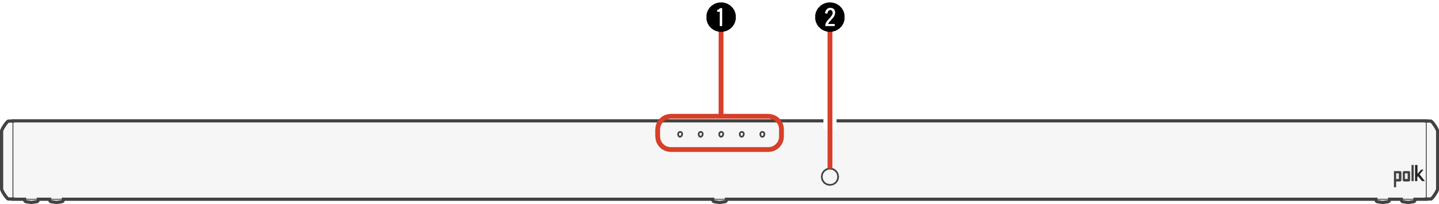

Front panel

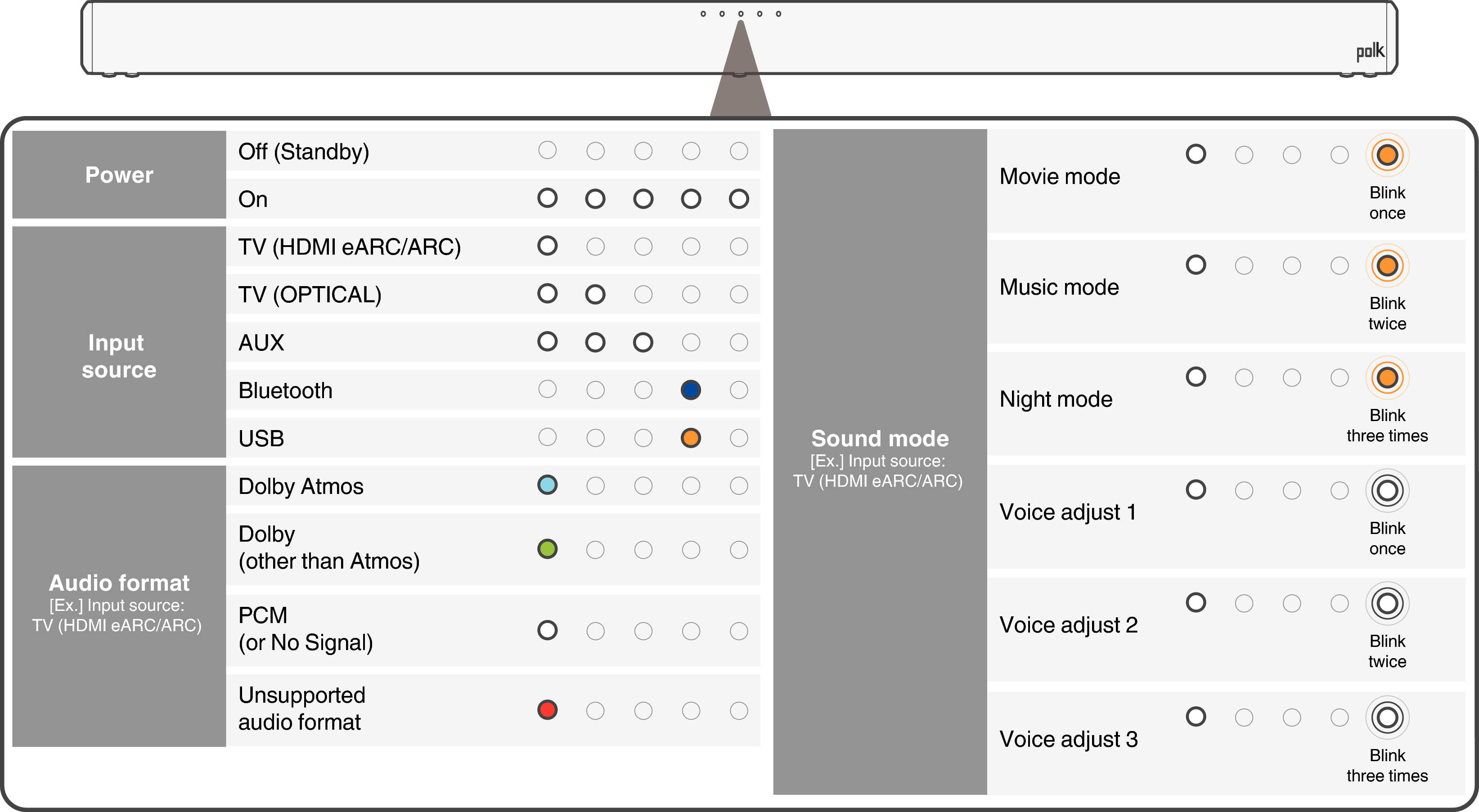

Status LED
The status, such as for the power, input source, audio format, or sound mode is displayed. link
Remote control sensor
This receives signals from the remote control unit. link
Status LED

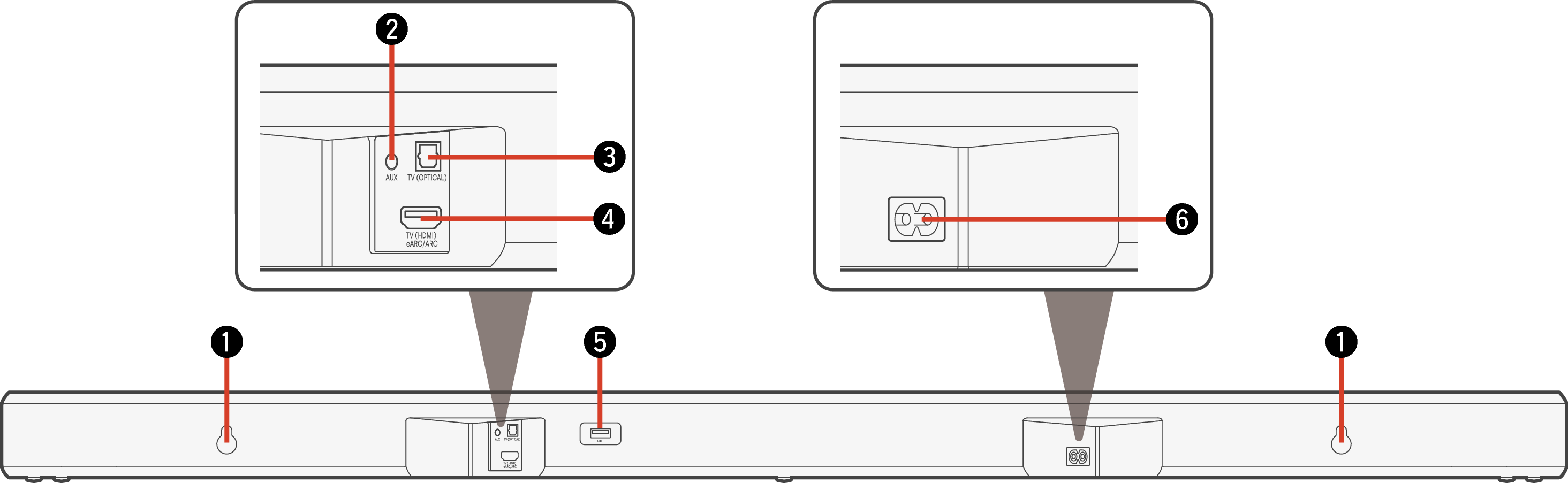

Rear panel
Wall hook hole
Used to mount the sound bar on a wall. link
AUX audio input connector
Use a commercially available 3.5 mm stereo audio cable to connect an audio device. link
Optical input connector (TV (OPTICAL))
Use the included optical cable to connect a TV with an optical terminal. link
HDMI connector (TV (HDMI) eARC/ARC)
Use the included HDMI cable to connect an eARC or ARC function-compatible TV. link
USB port
USB playback is available.link
AC inlet
Used to connect the power cord. link
