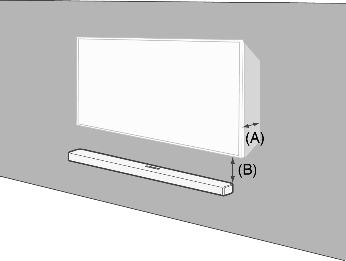

(A) Depth of the mounted TV |
(B) Required space between the bottom of the TV and the top of the sound bar |
Less than 2.5 in. (64 mm) |
More than 2 in. (50 mm) |
2.5 in. – 4.5 in. (64 – 102 mm) |
More than 4 in. (102 mm) |
More than 7.5 in. (191 mm) |

Leave enough space between the TV and the sound bar so that the sound from the Atmos speakers on the top of the bar, which projects towards the ceiling, is not blocked by the TV. Refer to the table on the previous page for spacing recommendations. link

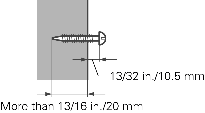

Screw in one self-tapping screw (commercially available, 3/16 in./5 mm to 1/4 in./6 mm diameter) into a wall that has sufficient strength to support the weight of the sound bar, or into reinforcing material on the wall.
The wall mount spacers create a space for cords to pass through between the sound bar and the wall.
