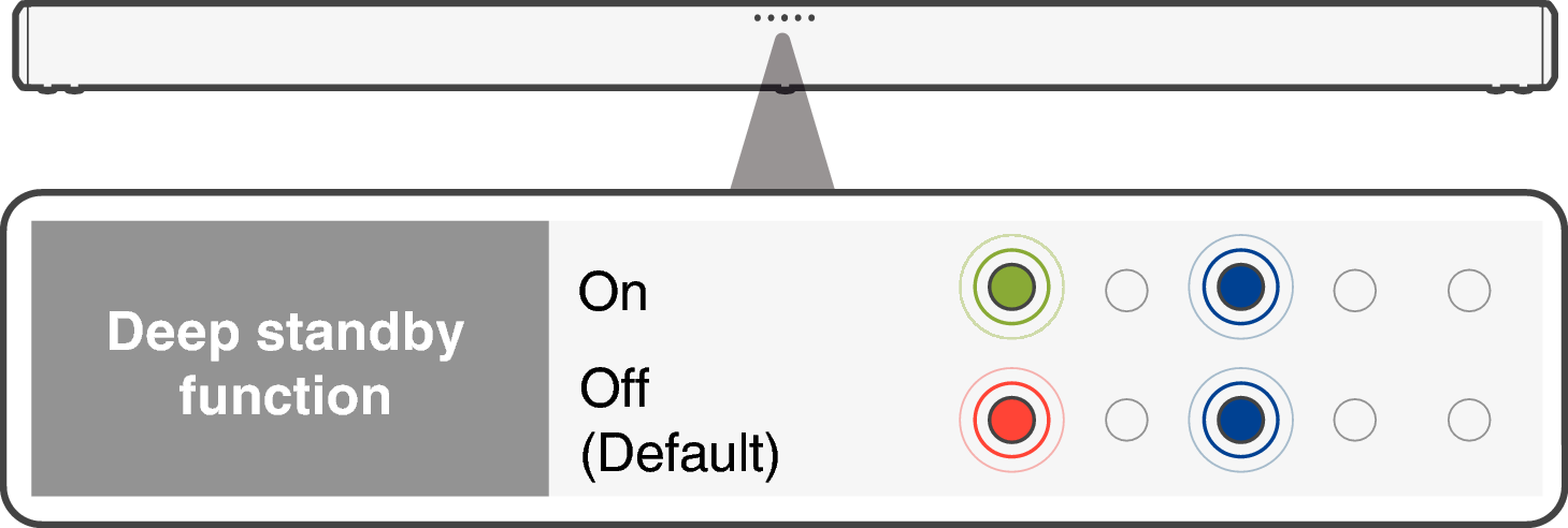

This unit can be placed into deep standby mode, in which its standby power consumption is lower than in normal standby mode. Perform the following steps to put this unit into deep standby mode.
The deep standby function switches on or off and the status LED blinks as indicated below.
When the power button is pressed while the deep standby function is on, all status LEDs blink in white three times and this unit enter deep standby mode.
When the power button is pressed while the deep standby function is off, all status LEDs blink in green three times and this unit enter normal standby mode.
